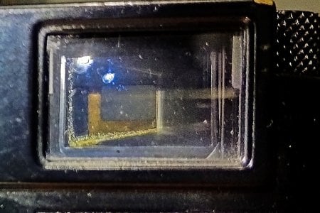

Here is a very poor mobile phone shot of said bubbling. Only bubbling along the front and lower edge are visible in this photo, however this level of bubbling is also present along the top and rear edge to the same degree.
When I have more time this weekend I will try to take a clearer photo if it would be of any use to determining a potential life-span of the prisim.

Very sorry, I just re-read your post and understand that bubbling does not equal prism separation! I will work on forgetting about it and taking photos 👍
