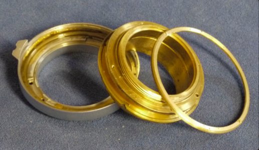

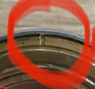

Check this post:
The wobble may relate to these parts。 Do not over tight the ring.

Check this post:
so far as I know I checked these rings and they are tight
