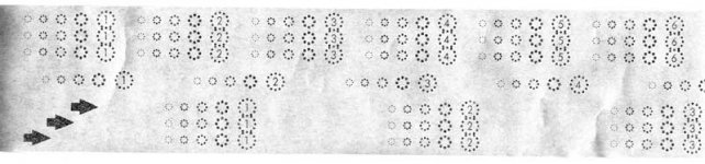

Here's a quick scan of the backing from the last roll of HP5 I shot:
You can see three sets of numbers placed across the backing, with different spacing for different size negatives: 6x6 in the middle, 6x4.5 on top and 6x9 on the bottom. There are little marks that appear in the window to indicate when you are approaching the number - when the little number is in the red window - stop!
ZeissFan
If you miss aligning Frame No. 1 by a millimeter or two, it won't make much difference. There is plenty of slack at the end of the roll to compensate for a minor miss.
