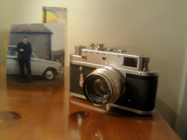

Last week, I scooped myself a Zorki 4 in very good condition bundled with the 50mm Jupiter-8 for less then £30. At that price, I was certain it was worth a go.
When the camera and lens arrived, I was happy to see that the Zorki was in great condition. However the Jupiter lens, although clear and mark free, had a very stiff focus ring, to almost a unusable state. With the help of friend (also a member here), I took the lens apart and cleaned all the relevant parts and re-oiled the focusing helix (thanks to http://www.pentax-manuals.com/repairs/j8service.pdf) and guess what? The lens feels great and as smooth as my other manual focus lenses!
Anyway, for my first roll through the camera, I used some 24 exp Superia 400 film, and snapped anything I could. I was happy to see that results where pretty good, even with my haphazard guesso-metering. I'm also very happy to see that the Jupiter-8 lens certainly has character, and is pretty sharp too.
I hope to throw some better BW film in the camera the next time around. But I must say, this cheap Leica influenced camera may have converted me to RF cameras! I was surprised how easy this thing is to focus, despite the smallish VF (compared to something like the OM-1), the RF patch really does help!
The camera..
