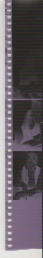

Yes, it's completely normal. Also : check whether the 30th works correctly : you might also need to clean the shutter mecanism as it's sometimes full of old grease, and it slows down the second shutter, occasioning blurry and overexposed pictures. See attachement : all the pictures were taken at 1/30, and the shutter only worked correctly once it was excercised and the grease was heated a bit...
