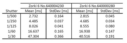

Hi all,
I would like to share my measurement of shutter time for two Zorki 6 (1964)
B.
Fairly consistent.
This confirms that the "new standard" 1/30 marking on the dial is still the old 1/25.
Excellent test results. :)
Have they been cleaned and adjusted recently, or are they of 'unknown' servicing history?
The camera No. 640004230 was recently purchased on ebay so its history is unknown. The second one was not used for over 20 years. I recently started to use it without cleaning inside or adjusting.
Dear Brankop,
I would like to know wat device you used to measure the times and speeds. The table shows speeds in [ms] microseconds. Actually the curtains of both camera's run to slow, and their drums and shafts will need cleaning and lubrication.
Nothing confirms that the 1/30 on one camera is still the old 1/25. That could only be confirmed by measuring the distance of the slith with at 1/200 or 1/500.
This is just a matter of adjustment. Its the time where the second curtain closes when the first has reached the end of its travel.

To be honest, all the figures show is the shutters are running slow, particularly at faster speeds. If the cameras are unknown or un-serviced, this doesn't come as a shock. It's not uncommon for shutters to run a bit on the slow side anyway.
Since you have access to the timing equipment, I'd make use of it by servicing the cameras and adjusting them to be as near correct as possible.

An missing information is that for each shutter speed, 10 experiment were done. A comment regarding the fast shutter speed: since the rising and falling edges of the photo-transistor output were not instantaneous, it is possible that the oscilloscope gave a bit biased measurement. I did not check what triggers the stopwatch: is it 10%, 50% or 90% amplitude of the observed signal. But then question is what would be the right amplitude.
RE: slow curtains
If you observe the first column, the shutter speed errors, relatively to dial numbers, are: +36.6%, +12.1%, 0.3%, -0.2% and 41.9%. To me, this implies that the error is not an linear function of the shutter speed. Can the curtains be adjusted for the each speed independently? Or one matches one shutter speed while other speed end up where they end up?

Ok, so 10 measurements isn't statistically significant to be quoting SD really. Thirty is generally considered minimum for meaningful stats.
To answer the second part - no, you can't adjust speeds independently. Essentially, the only adjustment is the curtain tensions. Based on my experience, these shutters tend to run at the right speed provided the mechanisms are clean and properly lubricated. Of course "the right speed" means the speed determined by the slit-width, which is not readily adjustable. I don't mean "the exact speed marked". Messing with tensions doesn't have any major effect unless you go to extremes, at which point you won't have a consistent shutter. If you adjust the top speed to give a consistent and even exposure (no capping or tapering) then that's pretty much as good as you'll get.
In honesty, I would not obsess over the speed being exactly as marked. Provided it's reasonably close then film latitude will more than take care of things. Also, the exact film sensitivity, type, processing etc probably have errors greater than shutter speed does.

professional shutter testers use at least three testing points to be able to get a decent measurement: one at the start, one at the end, and one in the middle of the curtain travel. You can't measure the shutters speed decently with only one diode or resistor....

Hello all,
Based on Ron's input, I remeasured Zorki 6 shutter time using three photo-transistors. Two transistors are located approximately 4 mm from the edge of the image plane. The third one is located at the center of the image plane.
Attached are results for 30 measurements for shutter speed 1/125. I also attached one sample wavefrom from the oscilloscope.
I did the experiment on both of the cameras and behavior is similar.

Dear Brankop,
Thats a very nice stroboscope you have! Well, the curtains never run at a constant speed during the exposure. They will speed up towards the end, and for this reason the with of the slit between the curtains widens towards the end.
For this time I disagree with Ron, you can also adjust and test the speeds using one point. The middle.
