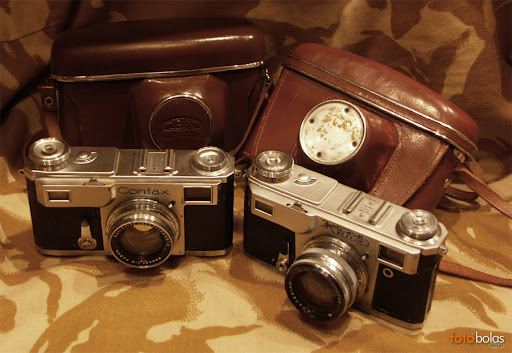

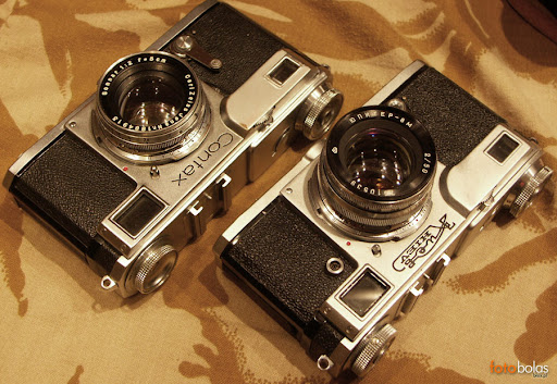

My new camera just arrived.

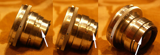

I have silly question about collapsible Sonnar 2/50 mm. Should i pull lens forward before start shooting ? Or maybe the should be left in collapsed position ? I have no idea ... Kievs don't have such things 🙂
Second thing - should those lens moving back/forward while i am rotating the larger milled ring ? Or is it moving just when you manually push/pull it ? I have no experience with collapsible lens like this one 😉
My first idea was that something is wrong with lens ...
Another question is about fitting lenses from the Kiev cameras ? Do they fit ? I was trying to change them and Sonnar 2/50 fits to Kiev with no problems, but in the opposite direction it was impossible to mount Jupiter 8M and Jupiter 12 on my Contax ... also a universal turret viewfinder from Kiev doesnt fit.
