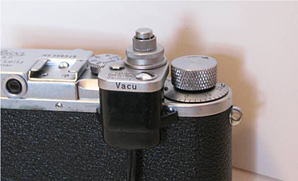

The COOIF and COONT were part of the CAVOO flash accessory for non flash synched Leicas, being available from 1951-53. Each was one of the two kinds of synchronizers units which were screwed onto the shutter release, and a special replacement CMVOO cam shaped shutter speed dial was used in place of the normal round one, to close an electrical contact on the synchronizer.
The COONT was for use with electronic flash and had a small sine wave engraved on it's back. Xayraa33 has a great photo of this COONT synchronizer in the note number 4 directly above mine here.
The COOIF looks the same as the COONT, but was used for long delay PF type flash bulbs. It was engraved "Vacu" on the back.
I have not learned how to adjust the timing of them yet, or know what shutter speeds can be used with them.
I hope I have finally mastered the art of adding photos to my notes, so if I have any kind of luck, the photo below shows the "Vacu" version COOIF on a Leica IIIa --
