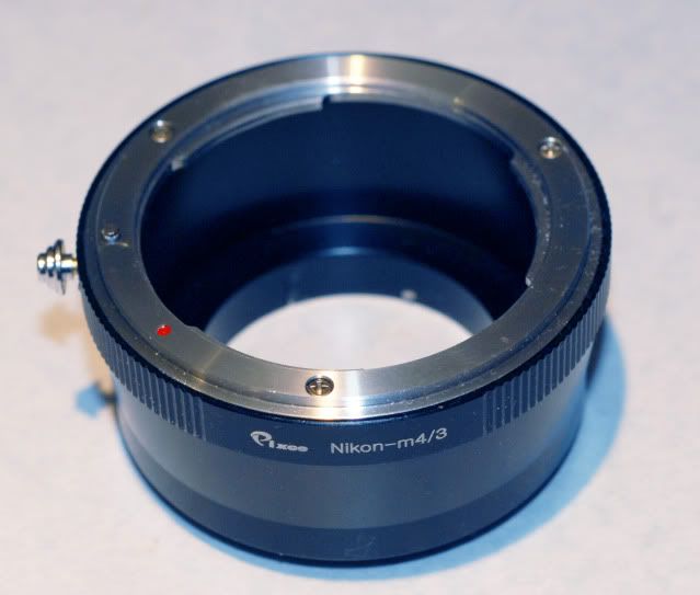

To build this adaptor, you will need a Nikon F to 4/3 adaptor. There are probably many different versions of this device, and some may not have the dimensions you need to do the job. I bought mine on ebay, item number 140339963002. I suspect the same part is available from Chinese vendors with different brands. The one I received looked like the one in the listing, but had a different brand on it. The vendor’s name is “Hard Man”

Part 3: The 4/3 adaptor
Here is the 4/3 adaptor as purchased.
A lot of metal needs to be removed. The great thing about this part is that the walls are very thick aluminum, over ¼” in my example. You will need all that thickness.
Unscrew the button of the F-mount latch. Remove the mounting flange from the body of the adaptor, and remove the latch body and spring, then put the F mount back on. Make all your measurements with the F mount assembled to the adaptor.
Chuck the adaptor using the internal lathe jaws, with the F mount in. With my lathe, the outer surface of the internal jaws had become fairly beat up, so I chucked in a round piece of stock, and carefully turned the outer surface of the jaws to make sure they were true.
Use a cutoff tool to get reasonably close to the thickness you need. If you don’t have a cutoff tool but do have a lot of patience, you can turn it all the way down.
Before you turn it too far down, make a flange on the inside of the workpiece to fit tightly within the screw threads of the mount to locate it properly, and make the final product much stronger. In my case, I turned the flange to 1.947”. With my adaptor, there was very little material to form this flange, so if the 4/3 adaptor has thin walls, or the inside diameter of the mount is not significantly larger than the inside diameter of the 4.3 adaptor, you will have problems. It is not particularly important how high the finished flange is, so long as it is less than the depth of the threaded part of the Kiev mount. I had been hoping to use the setscrews that originally held the mount onto the lens to secure the mount to this turned part, but there was not enough metal in this thin flange to do this.
Turn the outer part of the machined surface down to the dimension you need. In my case, this was nominally 0.322”. Be very careful here. You cannot assemble the Kiev mount to this piece at this time as the latching lever gets in the way, so you can’t measure the stack-up. Check your arithmetic a couple times. It is better to make it a tiny bit below the nominal; if the final product is too thin, you can shim the F mount to increase the dimension. You will have an opportunity to turn it a bit further later if needed. Undercut the edge of the flange a bit to ensure that the Kiev mount will sit flat on the surface.
You will find that before you finish machining this piece you cut into the drilling that housed the F mount latch. If you are going to have an F mount latch in the final product, you will have to cobble something up for it, as the original parts are too big.
