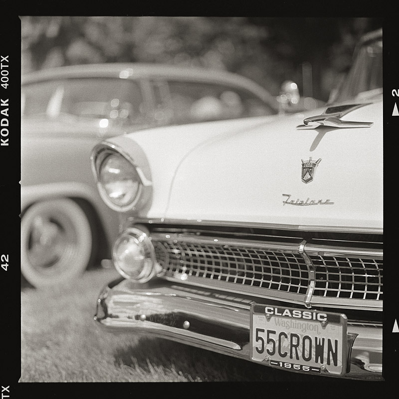

I've been using a Nikon F4 for this, equipped with the G3 focusing screen (due to the inability for the AF screens to accurately focus a lens with an aperture greater than f/2.5, and my clumsiness with the electronic rangefinder). I've been thinking though that it might be a good idea to shoot this instead on a manual focus Nikon like the F3 or FA, with a split prism focusing screen. Or is my F4 in its current state my best bet?

P.S. I really like your project idea, and I like your attached image of the Mustang fastback - all the best with it! It's a shame you will be scanning instead of making analogue prints...
I'm in my community college's darkroom techniques class (repeating as many times as i can until the college institutes their ban for taking a single class too many times) this semester, so I'll definitely be making a few enlargements from the best of these, probably a few 5x7's and a few 11x14's. But as for the cyanotypes (the end result of the project) I don't have a method of optically enlarging the original negatives. I discussed the possibility of putting some sort of UV bulb in one of my school's 4x5 enlargers, but my instructor for that particular class immediately rejected the idea. So for now, my only option is the school's 8x10 UV lightbox for contact prints.

But for the project in mind, I'm going to say the optimal camera for the task would be 6x6 or 6x7 medium format.
With a x4 magnification WLF and a split screen you would be able to blow any 35mm camera away when it comes to focusing accuracy.
Through the viewfinder, the basic 80mm f/2.8 on my old 501c is brighter and, a lot, easier to focus than the Zuiko 50mm f/1.2 on a OM1n.
The depth of field of the MF f/2.8 is comparable to a f/1.4 lens on a 35mm camera.
Pick up a 201F/202FA/203FE and 110mm f/2 and you have less depth of field than a Noctilux at a fraction of the cost.
On the other hand what camera/lens combination would give the best bokeh when photographing the detailing on classic cars ? ;)
As you want to shoot at F1.2, even with slow film, the top shutter speed of 1/8000 on the F4 is a big advantage over the F2 and F3, and even better than the 1/4000th on the FE2.
Go with the F4. I would also suggest looking at the E-Screen, like the B screen but with gridlines. Might help with the composition of the car's lines. A P-Screen has the split image and horizontal/vertical lines.
You might also use a 100 mm f 2.0 makro lens, the dof should be comparable. This was probably shot around f 2.8
