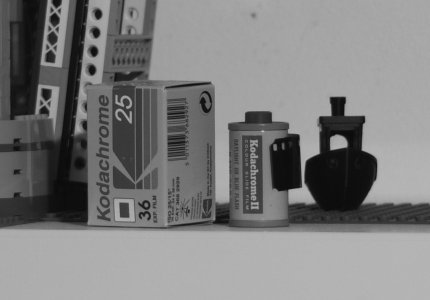

Who needs an SLR, as long as it's a 50mm and not a 55 or a 58 then a Shotten R-50 will give you RF coupling on an M. The M42 one works very well. I currently have a 50/1.8 Oreston on one and it is great. I'm picking up a Thorium Pancolor in a couple of weeks when I pass by family; looking forward to it.
The attached picture is a straight out of camera JPEG RF focussed at 6 feet on the Kodachrome box with the Oreston at 1.8. The zoom is at 100%.

My one comment is get exactly the right one for your target lens. What I mean is don't get a PK one hoping to use a M42/K adapter. It works but the M42 one pushes the aperture pin whilst the combination doesn't; though I have done DKL to K to M and achieved reasonable RF focussing with a Bessamatic Septon (but that was just playing about).
