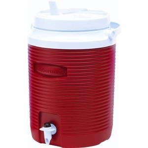

I use a Rubbermaid Victory Jug:
I know, it's not the best solution for long time storage but my last batch, which took me about 4 months with 1:3 to deplete, developed perfectly every time.
