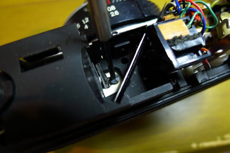

I've noticed that when the focus ring is set to infinity, objects in the distance don't line up like they should.
Furthermore, when it looks like an object is in focus about 50-60cm away, the lens reads 1m. About 1m distance reads 2m.
Should I go with the lens markings or the rangefinder?
In any case too many photos are out of focus!
Any tips on sorting this out will be much appreciated.

fullbeam, sounds like trouble. Of course we want all three in sync:
- Focus on the image plane
- Coincident image in the rangefinder
- Subject to film distance on the distance scale
Definitely needs adjustment. Saw this problem on one of my Yashica rangefinders (I have too many now). It was a routine adjustment for my local camera technician, but it may be hard to find one now days. Hope you can fix it; the GX is a great camera.
How to do it yourself? Sorry, beyond me.
About exposure... Sounds like your electronics are working; if they failed you would have gotten massive under exposure. I suggest a test. Camera on tripod, shoot the same wall at all f-stops. Look for consistent exposures.
Unfortunately, there is no way to reach the rangefinder adjustment on the GX without removing the top cover. But removing the top cover is not that difficult.
To adjust the rangefinder, adjust the focus to infinity, and then turn the screw with the + slots on the top, as shown in the picture, until the two planes of the image line up.

Frontman - thank you - excellent picture! Is it tricky to get the top off/back on? Anything to watch out for?

Taking the top cover off is easy, you need to remove the winding lever, and rewind knob, then a lock ring under the wind lever, and a Phillip's screw under the rewind knob, the top will then lift off.
