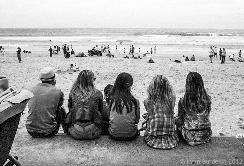

I blush to admit it, but it's been over 30 years since I've souped some film in my 40-yr-old Paterson developing tank. However the number of exposed rolls in the fridge awaiting development finally reached embarrassing proportions, threatening to displace ancient jars of pickles and an assortment of unintended biological experiments destined for the kitchen bin.
Here then are the first scans from a roll of HP5, souped in Rodinal 1:25 for 8 minutes, scanned on a V700 and pp'd in LR4.2.

I really like the grain.
If any of you knowledgeable folks can give me any feedback on the processing results I would much appreciate it. I'm not experienced at analysing faults in developed negs so any help is appreciated. I notice a water mark on the beach shot..

Nice pics, lynn.
But I doubt that it makes sense to make comments about the development based on digitally processed scans.
thanks haempe. Silly me. I should have realised that.
The negs look like they have good density. I have no idea if HP5 should look like this grainy when it's developed in Rodinal as described above. I also have some D76. I have lots to learn here..
Lynn, nice shots! Glad to see you immersed in the material world (even though you have shown some truly sublime digital images).
I have a "lesser" scanner than yours and do not see that grain introduced - I do not believe it is the scanner.
As I complained in another thread I have not got that level of grain with Rodinal, but I am always using 1:50. I think the grain is attained at higher concentration (Roger surely knows). I will give 1:25 a go next time.
Randy
The negs look that grainy also because of the scanner. I think you can judge the quality only when printed.
I disagree with this because I have shot the same type film, developed in Perceptol or D76 & my scans are smooth. When I use rodinal my scans on the same scanner look grainy. I just haven't found the right technique with rodinal. BTW I use mostly HC110 & the scans are not as grainy.

I have been using Rodinal for while, well the Adox Adonal version anyway and I have had similar results using it on HP5+ and other 400 asa films. I find any over exposure makes the grain even more defined but your grain is very strong so I'm guessing it has increased with higher concentration of developer you used .Unless I'm after the grain find D76 gives better results on faster films. I use the Rodinal on slower films typically Agfa APX100 which makes a very nice combination.

I dont't use Rodinal for 35mm film - to big grain from my point of view in most cases. For hp5 I usually use either xtol or Microphen, both diluted at least 1+1. Times based on Digital Truth + 1m if I'm printing on Focomat on Graded (2) paper.
