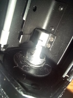

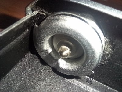

You can check the locks with this picture, they should look like this on the inside. I've seen them flipped after a previous assembly. A better re loadable film canister is a good idea though.
Mine is a 1975 model - serial number 7533415, so I think that's right. My locks are slightly different design to your camera back.
Mine looks like a different design. Problem is many different refinements and changes where made during production over the years at the Arsenal factory in Kiev. The pins in the locks stand prouder than yours and have a thicker base. You'll note the film back pressure plate is fitted the opposite way to yours.
I found the film cassette gets stuck on the left hand lock when you open the camera back, which explains why the film doesn't leave the cassette.

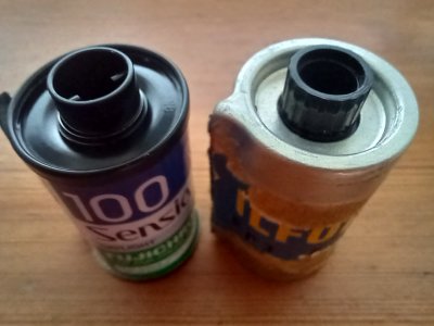

I didn't think I had any preloaded film and had forgotten I still have some expired Fuji Sensia 100, Circa 2006. Once defrosted, I have found this Fuji cassette fits perfectly in the Kiev 4. If you look at the picture below, you can see the problem of why the Ilford reloadable cassettes jam in this camera.
The FP3 cassette spool head is smaller than the Fujifilm cassette and I found the same for the Fomapan cassette I have in my camera display case. I think short annoying answer, is for this camera to be used it's got to be with preloaded purchased film. Never occurred to me they where different sizes. Think these Ilford cassettes I use date from the 1950s and 1960s.

There's two variations on the baseplate locks. Earlier Kievs don't have the "surround" for the central pin that yours does. Based on the Kievs I've got lying around here, it looks like yours was probably the first year of the switch. My '74 Kiev 4 doesn't have them, but everything from 1975 does.
(1974 Kiev 4 back on the right, 1982 Kiev 4AM back on the left - I should also note the Kiev 4 on the right is a "domestic" model with all-Cyrillic markings)
Either way, the Zeiss cassette fits and operates perfectly in every Kiev I've tested it with - even the 4AM. If you're a bulk-loader like me they're the best option by far.
