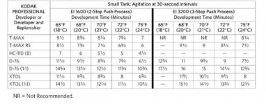

You may find the following handy information if you do shoot Tri-X.
