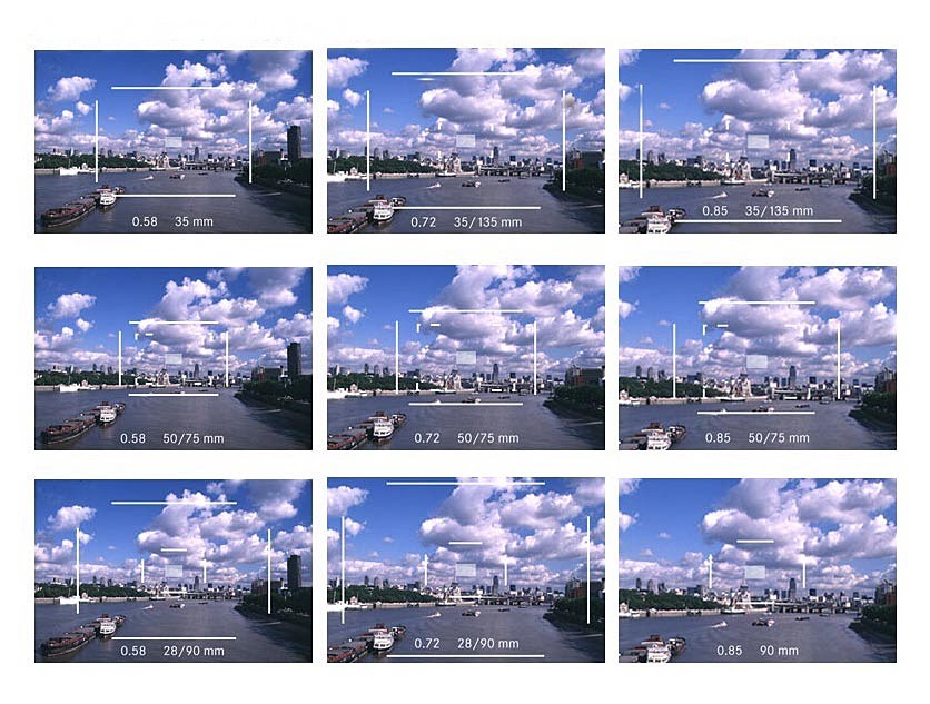

I'll be pulling the trigger on a film Leica soon to get over my decades-old obsession. However, this frame line business is still confusing me. My main lens will either be 24mm or 28mm.
1) Which of the film M has 28mm frame lines? The M4-P and the M6/M7/M-P, with 0.58 or 0.72 magnification only?
2) If I wear glasses, will I be able to see the 28mm frame lines?
3) If I were to use a 24mm lens, could I use the area outside the 28mm frame lines as a rough framing guide? I guess I won't see that if I wear glasses, correct?
4) Is buying a Leica M for a 24mm lens pointless because I would have to use a shoe-mount viewfinder, hence never using the "range finder" part of the camera, using it like a Bessa L (which I'm using right now)?

The M4-P has 0.72 magnification and shows the 28mm framelines. The other cameras you mentioned also show these framelines with 0.72 magnification. I have no experience with any of them with 0.58 magnification, but it's safe to assume they show the framelines because the low magnification is for use with wide-angle lenses.
I wear glasses and all my cameras have 0.72 magnification. The lines are there and visible. You need to explore with your eye to find them, but they basically cover the entire viewfinder field.
When it comes to anything wider than 28mm, it's better to use a finder. The 28mm framelines are just an approximation, and while they give you a good idea of what may go in the frame when composing, they're not going to be reliable for any other focal length. The reason is that they occupy almost the entire field of view of the camera finder, so there's incredibly little room for anything else.
Hence, buying a Leica for a 24 or wider lens is kinda pointless without a finder.

no experience with the exact questions you pose, but the 28mm framelines on a .68X finder are difficult to see even without glasses. Personally, I just pretend they arent there and use the entire viewfinder as the framing guide. Then again, if I'm wearing sunglasses I can hardly see 35mm framelines, let alone actually use them, so maybe it's just me. I can see and actually use 50mm framelines with my sunglasses. Looks about equiv to how 35mm ones look w\o glasses.
I think you might stand a chance to see the 28mm framelines at .58 but certainly not at .72 with glasses. (based off my experience with a .68)

Know that the 90mm frames work for the middle rectangle when using the rule of thirds as an aid in composition when shooting a 28 (for clarity understand that 28 and 90 frames coexist).
and a big X2 on this.
The leica framelines are very carefully designed and generally are not appreciated in this manner. I also tend to use the 90 lines in a similar way as I find where the 4 lines stop sort of also approximates the 3rd's intersections for the 90mm frame. And I also find that the corners of the 75 sort of "hug" the outside of the 3rd points on the 50m.

With my M7, M5, M240, the only way to see the 28mm lines is by moving your eye around the VF. You cannot see them straight on. The M7 and M5 have .72 finders. The M240 is about the same (there is no option on finders for that one)

To shoot the 28mm lens when wearing glasses, I use a Leica with a .58 finder. It is excellent with the 28mm. I can shoot my 24mm Elmarit without an external finder if I want to. I don't so much use the whole finder out to the edges, so much as to just "shoot loose" around the 28mm framelines, letting intuition/experience judge where the edges are. When the framing needs to be a bit more careful, I use either the Leitz 24mm finder, or the Zeiss 25/28 finder (great finder by the way).

1- All of those models have 28mm frame lines.
2- Whether you will be able to see the 28mm frame lines easily depend on which magnification finder, your eyes, your eyeglasses correction, the design of your eyeglasses' optics, the shape of your glasses frame, and the shape/fit of your glasses to your nose and face. A lot of dependencies, obviously. For me, with my face/glasses/corrections/0.72x finder on an M4-P, I can just barely see the 28mm frame lines all of a piece if I work hard at it. Normally, however, I just hunt around a bit to see them in parts.
If you're absolutely dependent upon seeing 28mm frame lines completely and accurately for your framing needs, you either want an auxiliary 28mm finder, or you want an SLR (with 100% coverage viewfinder) or EVF camera rather than a rangefinder camera. It's silly to didactically insist that you cannot frame with a Leica M unless the frame lines are perfectly positioned for your eye and then insist that you must have a Leica M ... It's not what this camera type is best at.
3- Yes. If you move your eye around a little bit even when wearing glasses, the 24mm FoV is pretty close to the whole finder view with a 0.72x model.
4- No. You use the coupled rangefinder view to set the focus, then you switch your eye to the accessory finder for framing.
