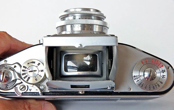

Now press the cute little button on the back of the finder hood to pop the magnifier back up, set the lens to maximum aperture, and peer down at the convex surface of the finder screen and you’ll see a clearer, brighter viewing image than you might expect so long as the finder optics and reflex mirror are in good shape. The finder is great for viewing and composing, but not so hot for precise focusing, especially at close distances and in dim light. Press the magnifier down until it clicks in place over the finder screen and you’ll see considerably magnified image of the central area of the image that lets you focus much more accurately, but then you have to pop the magnifier back up to compose the shot. This is infuriating, especially when taking close-ups of people, because maintaining proper focus is a crap shoot—by the time you actually take the shot the subject may well have moved.

Top view of Kine Exakta version 2 with hinged rectangular magnifier pressed down over the focusing screen. It provides modest magnification to aid focusing precision but only allows you to see part of the viewing image. Bummer. Also note classic Exakta ultra-long-throw left-handed wind lever.
