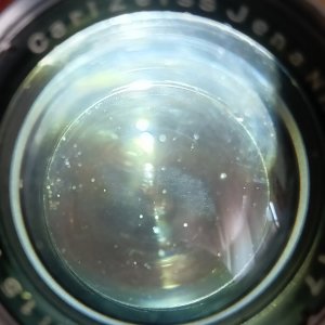

Hi all,
I was looking on the web for the production year of my CZJ 50/1.5 sonnar RF and I found your useful table.
It seems to me that my sample is what you call v3b ZJ CR cb, 1936-1939.
What is not matching is that you write that aperture can go further f/11 (up to ipothetic f/16) but in my sample it is not true.
Now I have to find out how to clean front lens from haze.
I know it is not a cemented element, so it should be possible.
At the moment I had no success, and an amount of haze is always there.
WhatsApp Image 2025-02-23 at 09.16.29.jpegWhatsApp Image 2025-02-23 at 09.16.29 (1).jpeg
Yes, I already removed the front lens and tried to clean it, but maybe it has etched as you wrote.
Maybe in 90 years of cleaning.
View attachment 4856969View attachment 4856971View attachment 4856972
Since it’s not coated, you could try to find someone locally who do polishing, I think it should not affect the optical performance if it’s not that deep (it seems)
I know somebody in my country who does this kind of business, that are optical manufacture companies who also accept private inquiries

SO- this front element needs to be replaced. A parts lens from SN ~175xxxx through to ~260xxxx would be preferred, as would be a matching version 3 Sonnar. I am being conservative on the SN, as v3 occurs before and after this range- but might be intermixed.
It seems to me that this group is really efficient.
I'm convinced I have to look for a new front element, but I think it could be hard to find.
In the meantime I will look for someone doing polishing here locally. Maybe it could solve the problem. Thank you very much.
