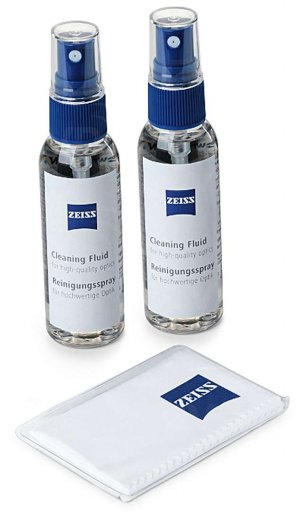

I do not use the pre-moistened wipes on my lenses, only on my glasses.
See if the Zeiss lens cleaner is available in a bottle.
OK, I am piqued. If used from a bottle as a liquid how is it manipulated that is better than the wipes? How do you do it?
Signed "Curious on the Columbia."
Was it self
I use an eye-glass lens cleaner that is a mixture of alcohol and ammonia. I then place under a UV light.
@GeorgeRazmadze
Was it self mixture or some kind of branded kit? What was the percent of ammonia? Thank you for your time.
I tried the Zeiss cleaning wipes on some lenses and they left residue.
For now I have settled on kimwipes + pancro lens cleaner. So far I haven't noticed any scratches left by this combination across my lens collection. I never use kimwipes dry or reuse them, and I always blow dust away with a rocket air blaster before wiping.
