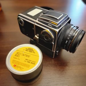

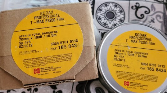

Will be interested to hear your experiences with that. I still have to get busy with my 2485 hundred foot roll. I spoiled it by using the wrong stop bath, it created an impenetrable dichroic fog, negs were -totally- opaque. Live and learn. Will be trying again soon I hope.Got two cans of 100ft 70mm Kodak P3200 Un-Perf. Going to check its condition.
2475 in 35mm was a fave of mine when doing reportage in the 70's.
Have you heard about the rubber wheel, replacing the std cog in the A70's? Works good, runs unperfed OK.

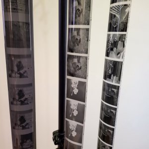

I developed first test roll of P3200 film. It looks like film has grain and need to be pushed about 1 stop during development. Also I'm going to try develop it in warmer developer. Filmed at ISO 400. Developer T-MAX 1+4 10:30 at 18C.
On the shot with films - the leftmost one.
PS Sorry for scratches. It was hard to fit it into my Cannon 9000f scanner.

Those look great, I don't see any fog at all on the right. That's quite a find. Excellent results. Thanks for contributing. Does this film have perforations? Are you using the rubber wheel if it's unperforated?

On the right HP5+ and Acros. This film (P3200) is non-perforated. But I filmed it with standard wheel for perforated one. There is small scratches at the film start. Now I also got rubber one. But it looks like you can film unperforated film with standard one.
