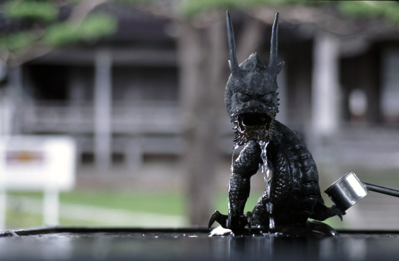

well as you can see, my kit includes the 35/2.5 the 50/1.5 and the 75/2.5
love the 35, my standard lens for the Bessa dory shot with buildings [execpt currnently it wears the 50 for the contest]
the 50 is nice for low light and can bring things just a little closer or more importantly get you a little farther away [ see my bird picture he did not like it when I tried to roll up on him with the 35 🙂 ]
the 75 is also I nice choice dory on the beach pic[ I was going to trade a Nikkor 85 but it was sick so I kept both and sent cash ]
I find my photography is going in a different direction with the RF cameras, so I am leaning more and more to the wide angles which is why the next lens was the 25/4 I am also happy with that as it allowed me to get a shot of a large thing that I could not get far enough away to get a otherwise good shot [see the Pilgrim]
