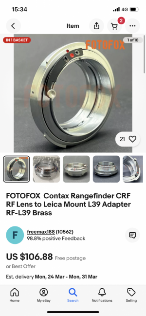

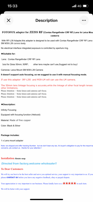

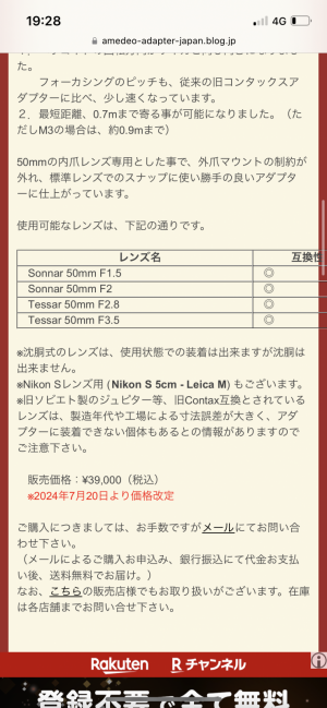

Note that one is in all chrome. If they went back to the original design, it might work.
The Adapter itself jammed on the Zorki, no lens on it at the time.
I use the adapter with Nikkor S-Mount 5cm F1.4 and F2 with no changes to the shim necessary.
I use them with the post-war Zeiss Opton 50mm F1.5 with the lens custom-shimmed for best use close-up and wide-open. This is an easy adjustment using the internal variable stand-off ring.
@GeorgeRazmadze, looking at that listing, I think this will be your problem:
1741787324838.pngThe notch on the cam there will likely be what snags on the wedge-shaped cam follower on a FED or Zorki, and this may be worse on a FED 2 than on a Zorki, as the cam follower on a FED 2 typically sits slightly lower in the lens mount/throat (which is why they often have issues with a Jupiter 12).
Frankly, I think this idea's a non-starter. Either pick up a non-Soviet body to use the lens and adapter on, or fork out for the Amedeo.
View attachment 4858345The notch on the cam there will likely be what snags on the wedge-shaped cam follower on a FED or Zorki, and this may be worse on a FED 2 than on a Zorki, as the cam follower on a FED 2 typically sits slightly lower in the lens mount/throat (which is why they often have issues with a Jupiter 12).

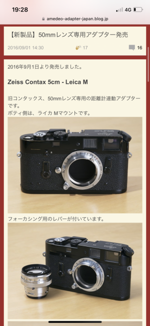

Thank you for your time and advices mr. Brian ✌🏻
Hello again. I think I’ll save money and go for Amedeo adapter than buying leica lens. May I ensure one thing Mr Coldkennels: So you are using zeiss opton 50mm f/1.5 on fed-2 with Amedeo adapter and it works perfectly yes?
@GeorgeRazmadze - Amedeo makes a true Contax to Leica adapter, which I own. I have the Zeiss lens on it now. Perfect focus across range on my Leica. Get the dedicated Contax to Leica Amedeo adapter, and use it on a Leica standard camera. Mine is M-Mount, the Screw-Mount version should also work with a Leica.
Yes. But also no.
My FED 2 is still set to the Soviet rangefinder standard to use Soviet lenses. My Zorki 5 has been recalibrated to the Leica standard to use actual LTM lenses from Leica, Canon, Voigtlander, etc. The Amedeo is obviously built to the Leica standard, not the Soviet one - so if you want to use it on a FED 2, you'll have to recalibrate the FED to the Leica standard, just as I did with the Zorki.
This isn't particularly hard, but it does require some patience and the right tools. You need to rotate the wedge-shaped cam follower slightly until the rangefinder agrees with the lens' focusing scale at 1m, then adjust the infinity focus until that agrees with the lens. That'll throw off the rangefinder at the 1m mark, so then you have to adjust that again. That'll throw off the rangefinder at infinity again, so back you go to adjust that. Eventually, through gradual adjustment at both ends, you'll get the rangefinder agreeing across the entire scale. At that point the only thing you should ever need to check and adjust is the infinity setting - the close-focus adjustment is pretty solid.

Thanks. Have you purchased Amedeo adapter from website for your Fed-2 and Sonnar lens and then you adjusted rangefinder as leica standard on Fed-2 am I right Mr. Coldkennels?
Thank you for your time.
That's basically it, yes. Although I've not adjusted my FED 2, only the Zorki 5. I normally use the Amedeo and Sonnar on my Leica IIIg, but it does work perfectly fine on the Zorki.
Just make sure you get one for LTM, not for M. The LTM Amedeo adapters are quite rare - supposedly, they're much harder to make than the M mount ones.
I think I meed this and it is only listing out there.
This is Amedeo's eBay account: Items for sale by amedeo.m | eBay
He puts up new listings from time to time, selling adapters as they're made. If you contact him directly about a Contax to LTM adapter, he might be able to list one for you.
