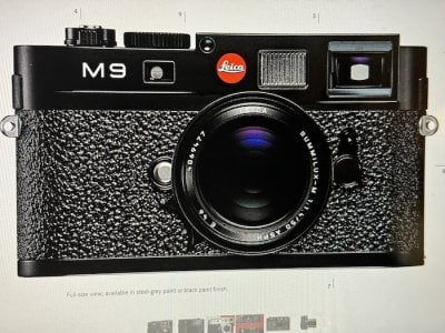

The Leica M9: A full-frame digital M at last!
Released in 2009 and in production (3 versions, including the Leica M9-P and Leica M-E) until 2012, the first full-frame iteration of the Leica M was a great success, with a total production of 51,400 units. Incorporating an upgraded 24 x 36mm 18MP CMOS sensor that maintains the inherent angular coverage of any mounted M-mount lens, the M9 incorporates many other improvements, including the ability to enter details of non-coded lenses manually, assigning one of the quick access buttons for manual ISO setting, an Auto ISO function that ups the ISO to prevent underexposures, and a “pull” option that provides an ISO 80 setting (the normal range is ISO 160 to ISO 2500).
Leica M9, black paint finish with 50mm f/1.4 Summilux-M ASPH. lens
The Leica M9 employs the same basic shutter as the M8.2, but the “S” (snapshot) setting has been moved to the user profiles menu, and the extra space on the shutter speed dial has been used for an 8 sec speed, expanding the shutter speed range from 8 sec to 1/4000 plus B. The main menu also includes a “soft” setting (in addition to the M8.2’s “discreet” shutter setting) that fires the shutter without going through the “pressure point” for the AE lock, resulting in a smoother release. The TTL exposure system reads off one white and two gray shutter blades, a system designed to enhance overall metering accuracy. In the large, bright viewfinder the projected, parallax-compensating frame line pairs have reverted to the traditional 28/90, 35/135, and 50/75 so lenses wider than 28mm require a separate shoe-mount finder. The viewfinder magnification remains at 0.68x. A comprehensive bracketing feature is available and accessed via the “set” button on the back of the camera. The small window that showed exposures remaining and battery status on the M8.2 has been removed—the info is now accessed via the LCD by pressing the “info” button. Finally, there’s now a slight “step” on the side of the body next to the main viewfinder window, a cosmetic enhancement to the M9’s attractive form factor.
PROS & CONS
PROS:
- The M9’s 18MP full frame CCD sensor is fitted with a UV/IR cover glass that largely eliminates the need to use lens-mounted IR and UV filters, to minimize color casts when photographing certain synthetic fabrics, as required with the Leica M8/8.2. However, this is not an anti-aliasing (AA) filter so full sensor resolution is retained. This enables the M9 to capture vibrant images with astonishing detail at low ISOs.
- A one-stop improvement in noise at any given ISO compared to the M8/8.2. The M9 sensor uses CFA dye for improved red sensitivity, signal paths in the output stage have been shortened for greater efficiency and speed (a new PCB design), two processors are now used for improved jpeg quality and speed, and entirely new firmware helps to reduce noise and enhance imaging performance.
- A new microlens array has increased offset at the corners to minimize the effects of shading, and there’s no limit on the lenses that can be used (even short back focus ultra-wide-angle primes) or the 16/18/21mm Tri-Elmar M.
- Excellent ergonomics overall. Most settings are intuitive and logically arrayed, resulting in a swift learning curve and excellent responsiveness in applications like street shooting, one of Leica’s traditional specialties.
- The Leica M9 was subject to “sensor corrosion,” where the sensor glass within the camera can oxidize or develop white spots, significantly impacting image quality. This is largely due to the unique design of the M9 sensor which lacks a protective coating on the sensor glass, making it subject to environmental factors such as moisture and high humidity.
- The M9’s sensor performs admirably within its design parameters, but it isn’t a match for current CMOS sensors in low light. It performs admirably up to ISO 800 and is useable but noisy at ISO 1600.
- The body of the M9 is only marginally thicker than analog Leicas and the M10, but it feels (and looks) fatter, and this adversely affects handing for some users.
- The M9’s LCD is not up to the same standard as its superb low ISO imaging performance. Many reviewers have panned its low resolution, limited viewing angles, and slow refresh rate, making it difficult to assess images, especially in low light, and compared to later Leica M models.
