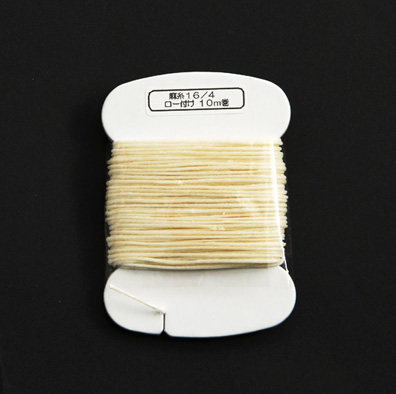

For the actual stitching, you will use a single piece of thread with a blunt needle at each end. The thread is generally beeswax-coated linen; the wax helps it pull through the work without breaking while locking each stitch in place. Al Stohlman's book says you must wax your own thread, and that store-bought thread is far inferior. I messed with this once, but found it to be a little too tedious and time consuming, and just buy it instead. The homespun stuff might be a little more pleasant to sew with, and I'm sure it has many devoted fans. The manufactured thread looks something like this.
