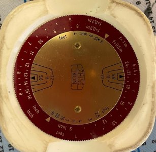

That is interesting, Zeiss proxars are 1m, 0.5m, 0.3m and 0.2m and the distance table is the rotating dial (red)
I assume the difference is due to a 45mm lens being used or the lens is a fractinal (1.xx) diopter
