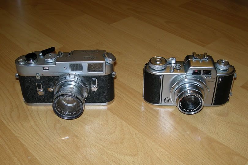

I've recently been given one of these (an AkArelle version I think, not sure which version, will check later when I'm at home) with lens in very good condition (although the transport mechanism is still a bit sticky)
the Schneider Kreuznach Xenar 2.8/50 it features is tiny! the 'inverted' screw mount is kind of cool, but can I adapt this thing to M39 or Leica M without too much hassle? Any ideas, suggestions, comments are welcome!

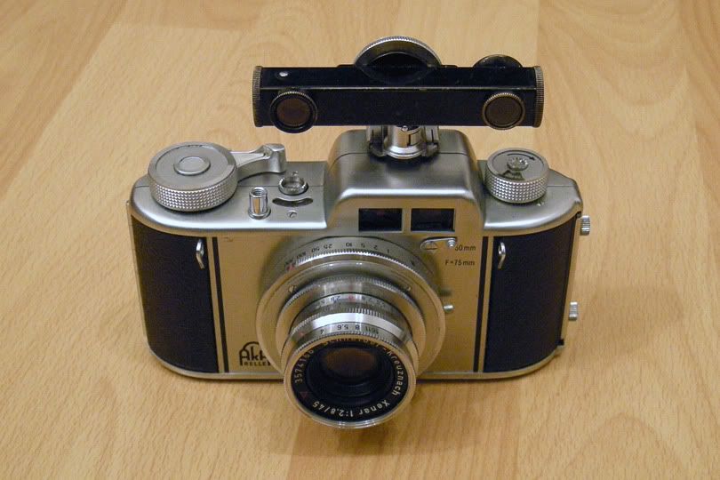

I was wrong about the lens; it is a Xenar but 2.8/45 and not the 50mm, it is small but heavier than my 21mm LTM Skopar for example, doesn't feel like aluminium to me. I successfully convinced the film transport to work properly now and cleaned the viewfinders. she's a pretty lady now!

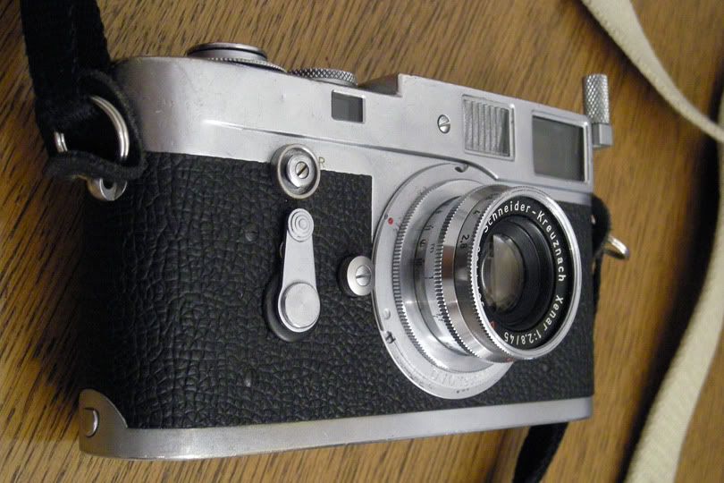

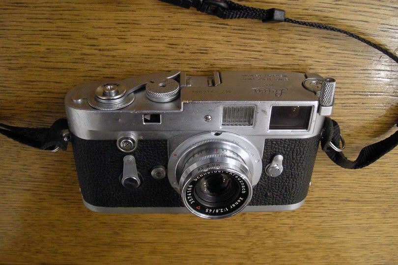

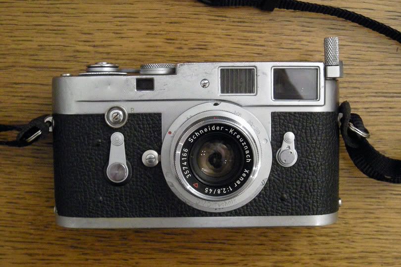

here's what the lens would (more or less) look like on an M body:
I could buy an old defective AkArette/relle body for cheap and try to take out the 'bayonet' part and adapt it to the M bay at the right distance, seems feasible to me...
The Xenar 45mm/2.8 can be found in some Retinas. At least IIF and IIS has it. It's a good lens, true to the high Xenar (Tessar like) standard found in Rolleicords for example.
Very nice and rare camera that Akarelle by the way.
