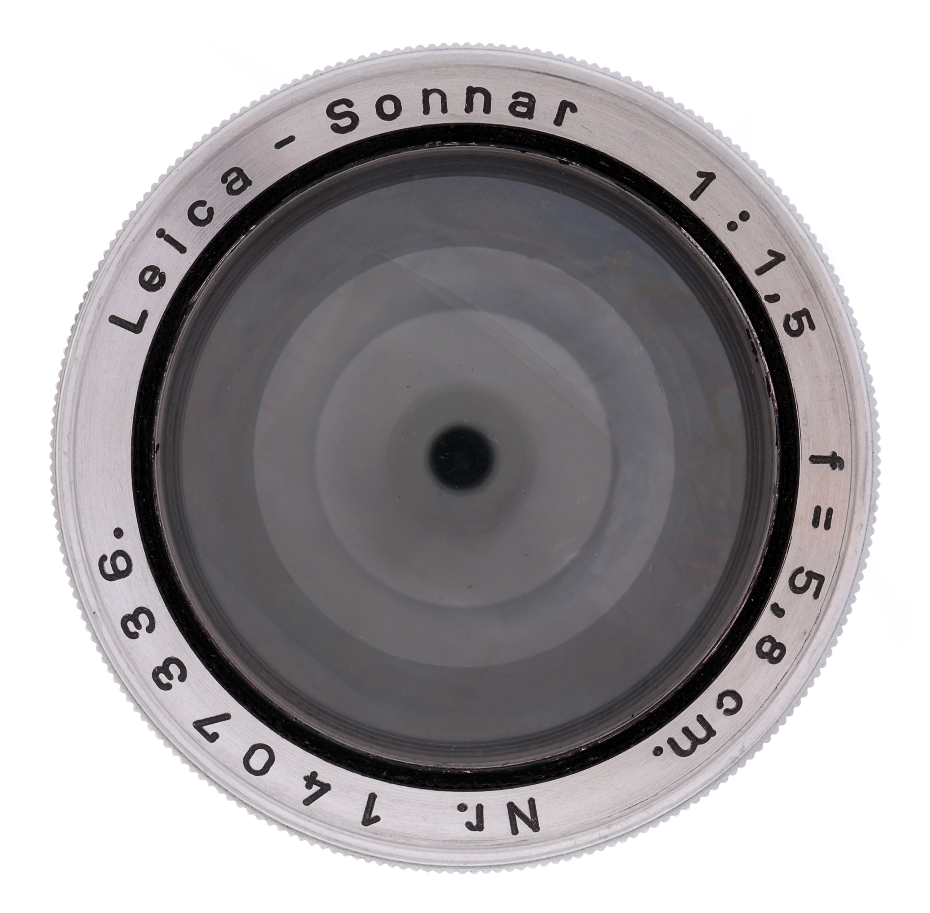

Another irregular production Sonnar
Took the 5.8cm lens out to a local historic site, it is a pretty decent lens. These were shot at f4 on my Sony a7III, straight outta camera jpeg, no tweaks on my part. Lower contrast as may be expected from an uncoated lens, especially second pic that has bright light streaming onto headstone.
It warmed up this afternoon- and I had a chance to put the Sonnar on the Amedeo adapter and use on the M240. The focal length is 5.8cm, but marked 5cm. The lens is Contax Mount. It focuses correctly at infinity. BUT- to use on a Contax camera would require a custom RF mechanism in the camera. I think it was used for an application for infinity focus only. I've seen custom cameras and lenses built for this.
The lens uses 40mm filters and hoods, like the pre-war 5.8cm F2 Biotar. One more piece of this puzzle. The SN starts with a "3", which would put it in the post-war range for CZJ lenses. If you drop the "3" and go with "144", I've seen others like this in that range.
Wide-Open
All focusing using the EVF2 Liveview on the M240, 5x magnification.
Conclusions? It uses 40mm filters. It takes far better pictures than I thought it could. The others that I've handled had some scratched up glass in it, looked like shooting through vaseline.
Speculation: If there is a 5.8cm Biotar, we're going to make a 5.8cm Sonnar! And forgot the RF cam had to be sloped for a Leica, and that they would need an external focus mount for a Contax. "Maybe we can sell them as Eyepieces." "Maybe we can hide them and pretend we never made them." After the war- Moonlighting at the Machine Shop.

I was surprised when the standard 40.5mm hood did not screw in. Then- remembered by early Biotar takes 40mm accessories.
I had the same issue with my 5cm but really 58mm Sonnar using the sam Walz hood. A single wrap of teflon tape worked well.

Dexdog and I met up yesterday at the Army Museum in Norhtern Virginia- I had the chance to compare his LTM 5.8cm F1.5 with my Contax mount 5.8cm (marked 5cm) F1.5, the latter marked 5cm. The optics and their fixture are the same. The LTM version has a precisely made indexed cam to maintain proper focus throughout range. My lens is in focus at infinity on a standard Contax. It's possible that the lens was made to go with a modified body, with a different pitch helical- but I doubt that. I've seen other lenses made for special applications that are fixed-focus at infinity.
The lenses are well made, and perform about the same as the 1930s pre-war Sonnars. I've seen several that led very rough lives, the glass is damaged. Dexdog and I have very clean examples. The optics are uncoated. The serial numbers on these lenses "are all over the place", but mine starting with "314"- a new RFF member has one that is 2 lenses from mine. Are they worth the ridiculous prices asked for them by some Ebay sellers- no, not for their performance or even for the mysterious history. But they are Sonnars, optics by Zeiss, and manufacturing an unrecorded part of recovery after WW-II.
