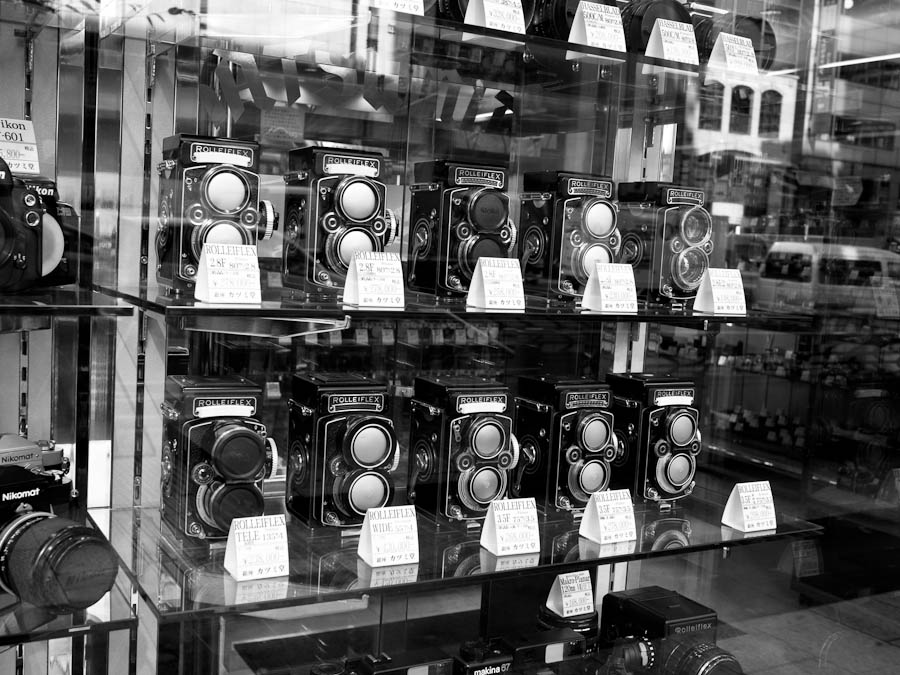

Can't resist stoking demand:
A store window in Ginza, Tokyo.
