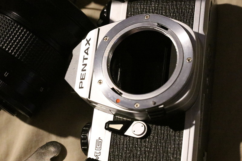

As an aside, the K to M42 adapter is a wee bit tricky to get on and off of the cameras. It comes with a tool, kind of like a huge wind-up key with two tabs which go into two slots in the adapter.
To put the adapter on the camera, you need to get it EXACTLY in place and push against a spring thing on the left (as looking toward the lens mount) side of the mount and get the opposite slot carefully lined up with the f-stop actuator tab.
That's the easy part!
You would think it's just the reverse to get it off, huh? Wrong!
You first use the tool with the one extended tab to carefully compress that spring thingy and partially turn counter-clockwise. Then you have to pull the tool out somewhat and continue turning to get it fully out.
Oh well, I think things are looking good for that little project.

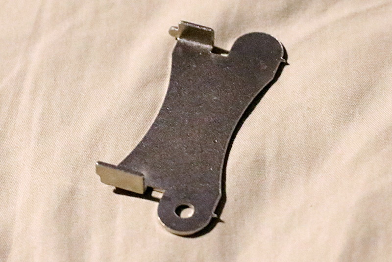

No, this is a white-box no-brand generic one. However it looks exactly like the one shown in TFM except it says "M42 Pentax" instead of "Asahi Pentax" on it. It fits securely and the lens screws on smoothly.
Below is the page that discusses the adaptor in TFM. In the middle is the one I got, mounted on the MG. The bottom is a close-up of the tool that was included.
The manual says to put it on the lens before mounting to the camera. I did not try that and it may be easier that way, so I may try it.
Because of the way that spring thing works, I don't see any way to reverse the process. TFM says to unscrew the lens and use "a pointed object" to release the spring.
The tool has the extended tab on the top in the view below. It's fairly easy to push all the way in, turn once, back out, and turn the rest of the way.
