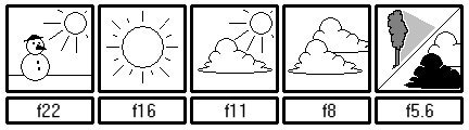

Couple of weeks ago, I dug out the film rangefinders from the attic, after having shot digital exclusively for 6 months or so. In the mean time I sold my light meter along with the 6x6 system.
But wouldn't you know.. of course one of the RFs doesn't sport a meter (leica m4 by the way). Shouldn't be a problem of course, as every film comes in a cardboard box with a little exposure guide inside. Well, that's how it used to be. Not anymore.
I looked around on the web, but all the exposure guides I could find are textually prolific, which isn't my ideal when I'm out there concentrating on shooting. Well, I spent some quality time making those little pictorgrams myself for 1/ISO shutter speed.
So for anyone else looking for something similar, I'll attach my creative efforts..

Good job. After not having a meter for years, I bought one last year. Then I left it in a pocket when I did my laundry. So am again without a meter. Once you get the hang of it, working meterless isn't really that difficult. Most photos before 1950 were taken without a meter.

PS: thanks for the Grapic Guide 🙂
