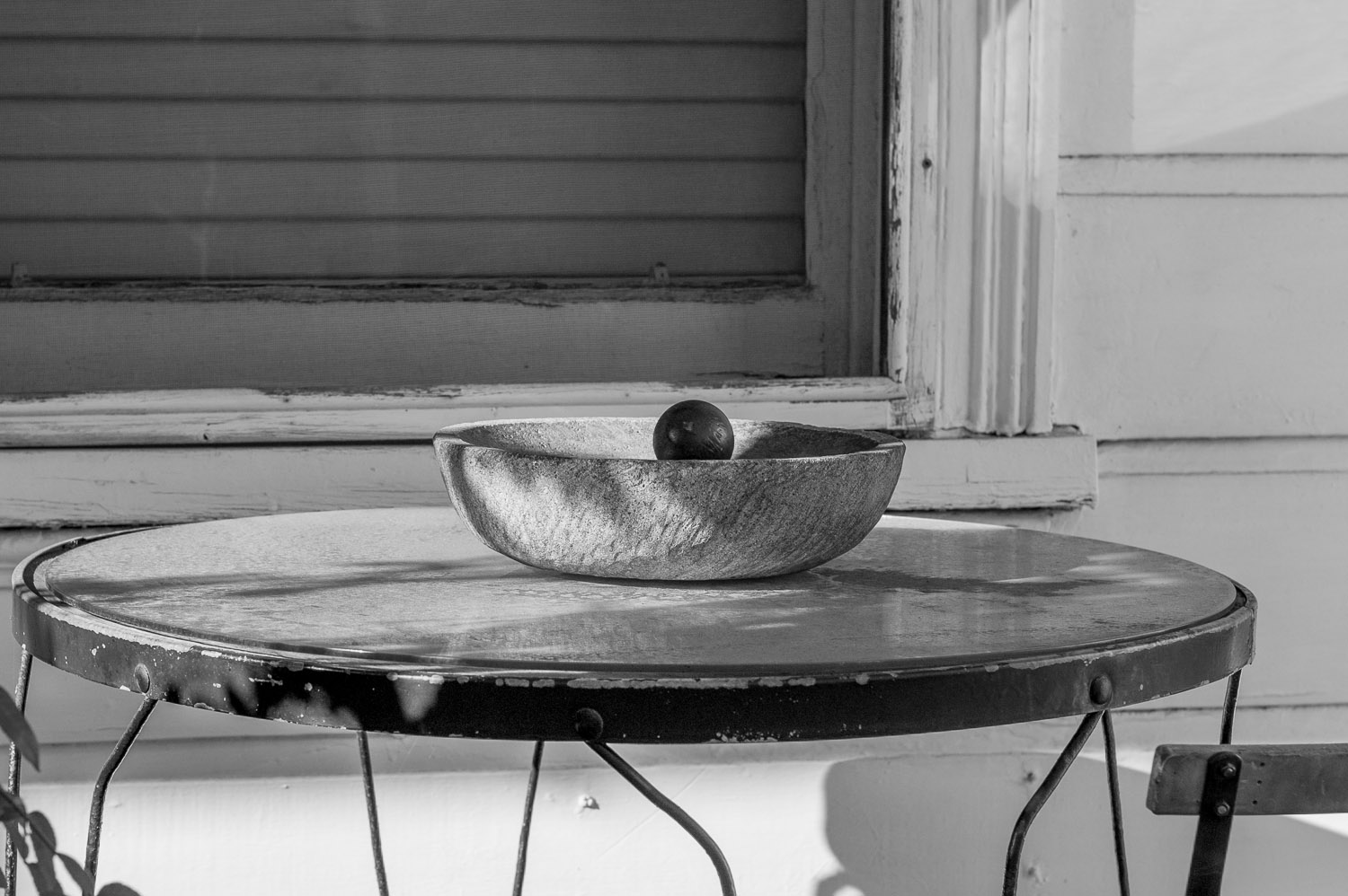

Converted in Photoshop using Topaz BW Effects 2 plugin.
The Original.
Topaz
Original
Just for giggles here, I've been playing with your first vacuum image above in Gimp, trying to get it as close to the Topaz image with minimal adjustments. Using curves to lower the blue and green slightly, I seem to be able to get it fairly close.
One thing I noticed is that your B&W image is still in RGB mode instead of greyscale. Is there a particular reason for this?
The full resolution image is in grayscale. I post photos to the web in sRGB because grayscale images do not always render correctly in all browsers.
