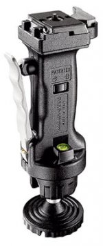

I use one of these (manfrotto 222 joystick) for my Rolleiflex and I think it's too big and way too heavy. the head is about 0.75 kg.
To qualify that; I use it when I hike into a (my local) national park. It usually seems much heavier on the way out than it did on the way in.
I'm looking for a lighter one.
