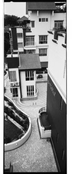

Been revisiting Neopan 400 again.
This time, pushing to 1600.
I find it less grainy than Neopan 1600.
Attached pix is np400 pushed to 1600, souped for 10mins in d76 1+1 at 29.5C.
