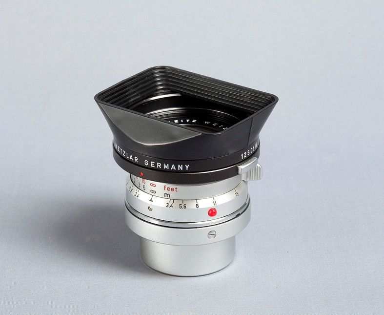

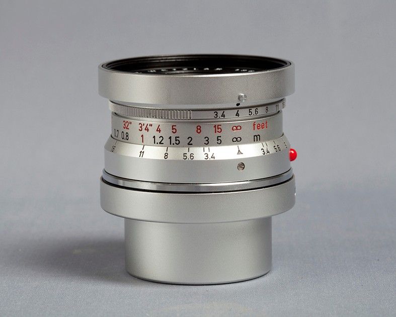

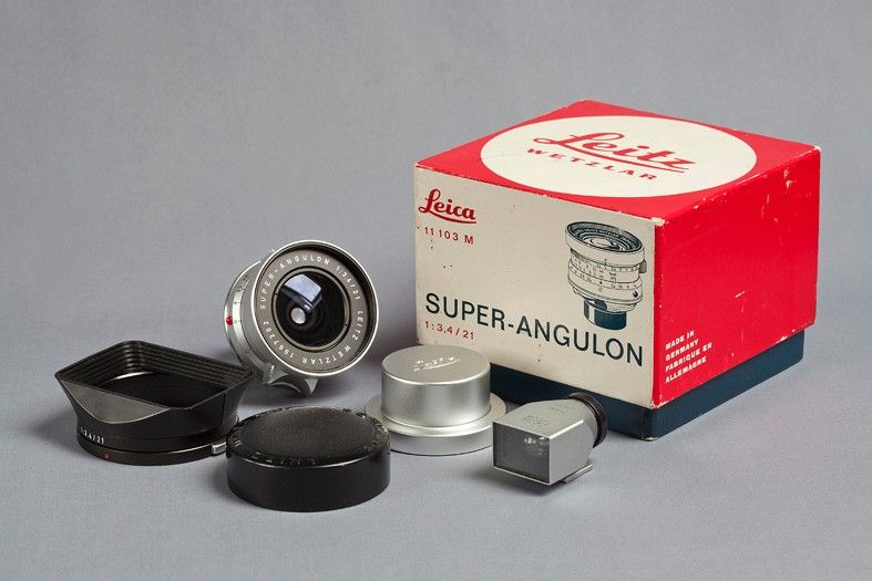

Good evening everyone ,
It cost three times today!
I just got it this week for 2.000 usd ! :bang:
It SN is 1967xxxx but I'm very satisfied 🙂
ww.ebay.co.uk/itm/Leica-Super-Angulon-21mm-f3-4-Lens-with-Hood-21mm-Viewfinder-Boxed-Mint-/200965913072?nma=true&si=ID%252BMMBxunshcNv1Z%252B8FgpraOcQw%253D&orig_cvip=true&rt=nc&_trksid=p2047675.l2557
Here my first test : Super Angulon 21mm/3.4 _ 1/60-f:3.4 -160
ASA _ Leica M9. Hand held .

Leica Super-Angulon 21mm f3.4 Lens with Hood & 21mm Viewfinder - Boxed - Mint-
Seller information: Oddozie (1817)
tem condition: Used
Ended: 27 Sep, 2013 19:20:10 BST
Price: £1,399.00
