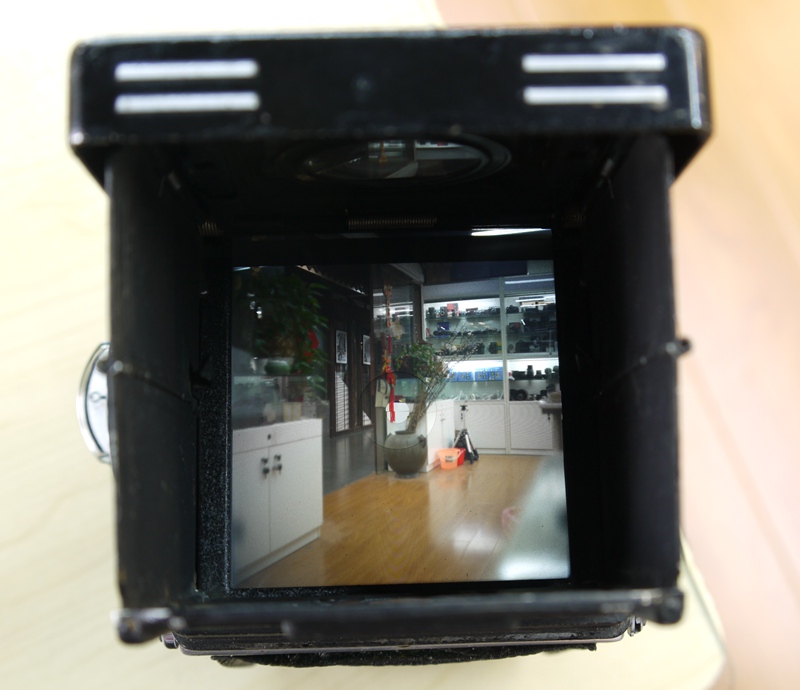

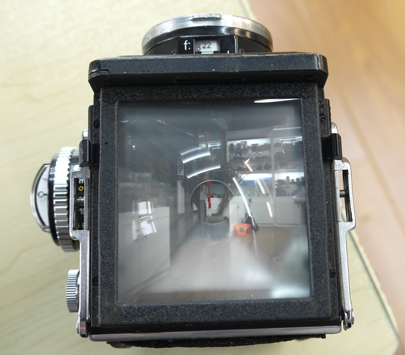

I've been doing some research lately and have tried a couple of options, the Mamiya RB, the original Rollei screen, a cheap fresnel one that was given to me, an unknown fresnel on my 2.8F that came with the camera, but still not really to spend the money on a Maxwell.
Has anybody tried these screens from ebay? from this link
It looks promising...
and would love to hear some opinions about that screen, is it worth it?
Thank you!
