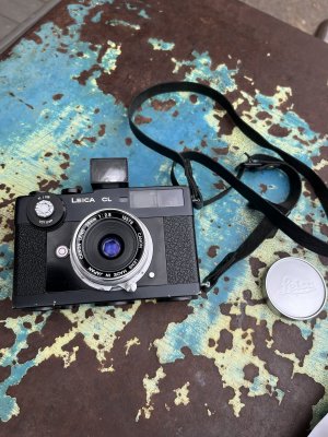

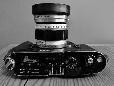

50mm lenses Canons can be had at a relatively low price. The 50mm 1.4 is a great lens around $200 currently (somewhat large ....photo 4) while slower lenses like the 50mm 2.8 LTM can be had for as little as $50.
