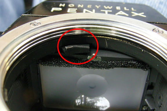

The ES camera is a M42 screw mount, my reference to a "hook" in the lens mount was to this--circled in red:

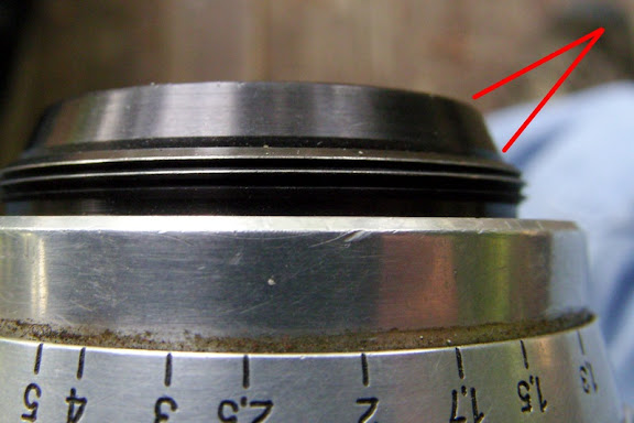

And the Biotar I own is this one:
And the mounting problem on this camera is caused by the "extra" metal after the screw threads--again, marked in red:

The Hook on the ES is to allow wide-open metering with the later generation Super-Taks that came out with the Spotmatic II.
I used a 42mm "universal screw mount" Tessar with my Cosina STL1000, but had to file the offending metal down. Otherwise it hit the camera's plate that stops down the aperture of the lens.
Praktica models prior to the L-series, except the Super TL, should provide the greatest compatibility; for lenses made prior to automatic diaphragm actuation with long threads, the actuator plate inside the lens mount can be disengaged if the camera has this function, but if not, as in pre-FX2 models. then no problem at all. The automatic diaphragm actuator in the Contax-Pentacon models cannot be disengaged, however.
