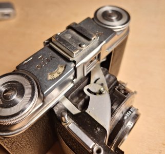

And so I took home the Vito II and a pretty little Kodak Bantam folder (bakelight construction). And they've been sitting on my bookshelf as display pieces ever since. Now, the Bantam has a working shutter but the standard catch is broken and gone, and who can really bother trying to find 828 film loads any more? But a few months back I was looking at the Vito II and wondered if the shutter worked... It almost did! I would make one rather lethargic exposure and then jam, and after a few minutes of jiggling it and working the shutter speed ring around, it would make another. The lens looked to be fungus free, the bellows (despite a ton of dust) looked sound. Hmm. 'Probably needs a good cleaning...' So I sent it off to the repair shop for a clean and service.
A couple of months later, it has returned with all the externals and internals cleaned, adjusted and lubricated. It needed a new mainspring for the shutter too. (Expensive, a whole $12! LOL!) The shutter works beautifully at all speeds, the little Color-Skopar 50mm f/3.5 lens is clear and ready to be used. I found an instruction manual for it and loaded it with ACROS 100 film just now (appropriate to its 1/300 maximum shutter speed).

Advance Camera Repair did an excellent job of the repair and CLA! Everything on the camera works smoothly, precisely, just like you'd expect from a Voigtländer of that era. The shutter feels and sounds great!
G
Yes, as long as you remember to lift the lever to wind on they're lovely. Not having used mine for years, it took me an age to work that out again...
Those two pimples either side of the viewfinder are for a clip-on accessory shoe that is not only impressively ugly but also mashes your chrome underneath. Goodness only knows what they were thinking.
I'm kinda glad I don't have the cold shoe adapter. 😉

The peephole viewfinder is workable for me but does require a good bit of squinting for my eyes with glasses on. Of course, since I don't really need my glasses to see through it well enough to frame and there are no focusing aids in the viewfinder, I could live with it. But I found one of the 333/23 Accessory Shoe adapters cheap (about $30) and I have the Kontur 35mm viewfinder already ... that will make shooting with it nicer since my eyes work well with the Kontur viewfinders. I will have to find some way to protect the camera from the accessory shoe adapter — don't want the camera to get all scratched up, the metalwork is nearly perfect right now.

can you push the lens back into the camera with that filter on? I am not able to do so on mine.
Not that I can recall. I'm pretty sure I removed it when closing and left the camera open between exposures while in use because of that.
PF
Always best to remove filters/hoods/etc and set the lens to infinity before folding any of these cameras. Some can handle a filter, but not many ... can cause problems and jam things if you try to close with lens accessories in place.
