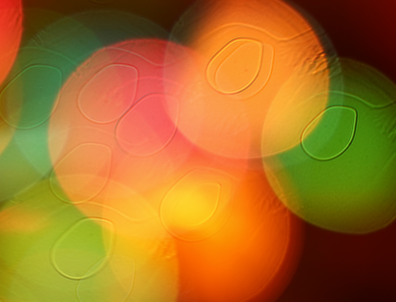

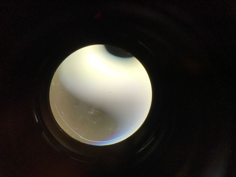

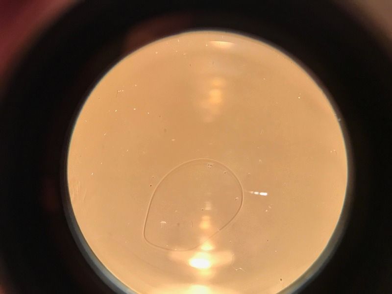

I've been buying vintage lenses on eBay for 15 years now and have (for the most part) had excellent buying experiences with good quality glass that was as described. I purchased Konica Hexanon, Rokkors, Russian Zenit and Rangefinder lenses, the Pentacons, Carl Zeiss, and many many others with no issues until this past year. I would have lived with the scratching, but the lens separation and glue issues really hurt the quality of the glass for night shooting with bokeh and specular light sources.
I heard the LTM lenses from Canon's old rangefinder line were notorious for balsam separation and these glue issues, even reading that on these forums which I am new to BTW, but I was okay with taking the lens apart to clean up haze but the glue issues are just hard to overlook! :/
Nate
This is what shows up in the bokeh which is visible separation that is sometimes hard to see when looking through the lens but is painfully obvious in images.

Canon lenses of that era are notorious for element separation, and there are quite a few old lenses that have very soft glass - to the point where finding one without cleaning marks is practically impossible. If you want to use the lens, you settle for this, it's not going to ruin your photos.

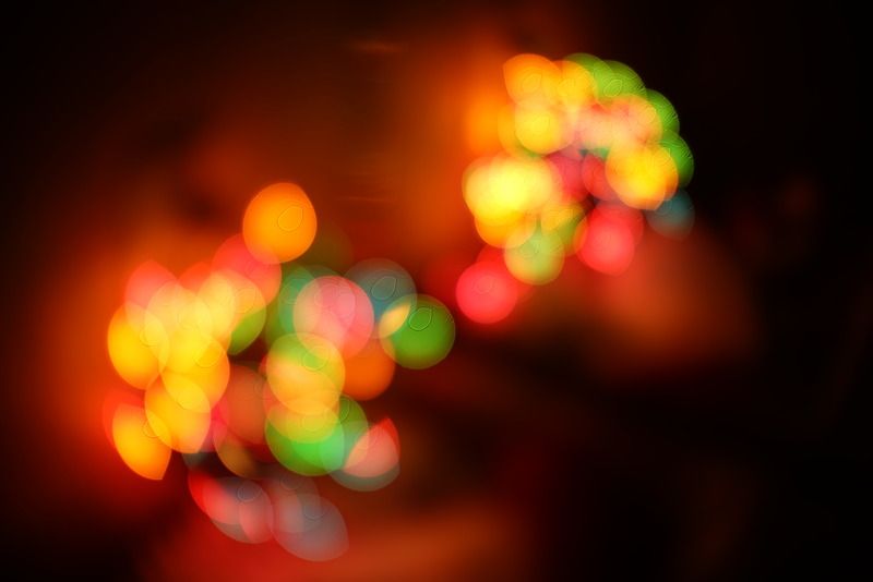

I have several vintage lenses that I use, some of which I have shot for years where the glass is vintage but clean with no separation, major flaws that ruin the bokeh. I'm talking the Tomioka 55mm F1.2, Porst 55mm F1.2 and lenses like the Pentacon 135mm F2.8, Jupiter-9, Jupiter 37A, old industar lenses. This only seems to be a repeat issue with the Canon? I'm okay with using mint lenses, but is the separation issue so common with the Canon 50mm F1.2 LTM that it is "impossible" to find one without the separation? I've come to the realization that I can live with the micro scratches and cleaning marks, even haze (which can be cleaned) but the separation is unnerving which is why I probably need to totally give up on this lens and go settle on something like a more recent Minolta Rokkor 58mm F1.2 lens!?
I simply loved the way the Canon rendered the bokeh... It's a shame this has to become an issue for night shooting. It's why I got the lens for street shots and narrow DOF at twilight and late after dark...

You can send it for professional recementing and polishing, will cost money, but if that's what you want this may be a sure way to get a working copy.
