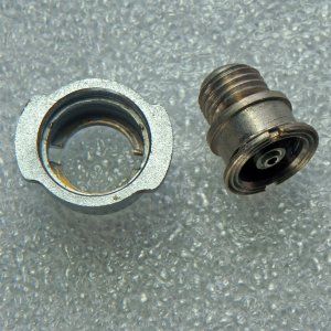

Camera fixed and ready to load - check out the before and after pics showing the repaint that a previous owner had done that resulted in the frame selector being painted stuck on 35... all sorted now : )
