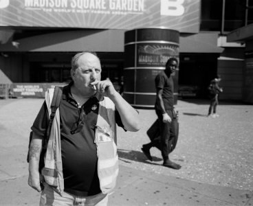

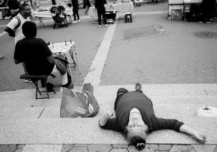

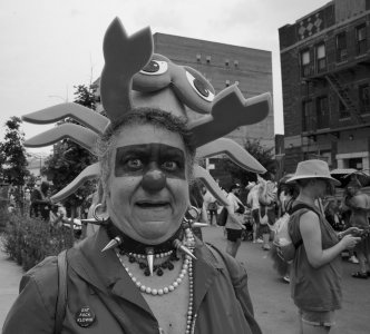

Hi everyone,
Longtime mirrorless shooter with legacy glass. I recently began to shoot film, 35mm and MF. Prior to shooting with my Canon A1 and FD lenses, I used my FD Lenses on my Sony A7 Mirrorless camera.
Is it normal to have my old film glass appear sharper on my mirrorless digital than from my lab's professional film scans? Is it due to film's inherent grain structure that there is a perceived difference? Normally, I shoot zone-focused, so I know very well when I have outright missed focus. Even when I adjust focus on a fixed object, I don't get the same sharpness.
I have attached a couple sample images for review/discussion. I'm at a bit of a loss because I love the tones and process of film, but see myself pining for the critical sharpness from digital.
The shot from the Mermaid Parade is digital with Canon FD. The other three are 35mm, Canon A1 with FD glass.

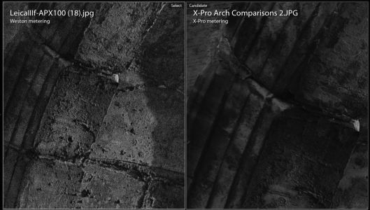

As for direct comparisons, I did something similar to check dynamic range and exposure some years back. I used a 50/3.5 Elmar on a Leica IIIf and some (old, pre-Kenmere) Agfa APX 100 in Rodinal for the film, and an X-Pro 2 with Fuji's 35/2 XF lens for the digital exposure (I didn't want to use the Elmar on both cameras due to the crop factor of the X-Pro).
Here's the full frame of both:
It should be pretty obvious, even at this size, which is film and which is digital. But here's a screenshot of the two side-by-side at 100% in Lightroom at the point of focus:
The Fuji shot is an out-of-camera JPG. Both shots have the same sharpening settings. I was honestly a little surprised by how well the Elmar and APX 100 did in this comparison; it's very non-scientific as I was mostly testing exposure, but it does illustrate that film is still more than capable of producing good results in the modern age.

All valid points. The film shots were all shot between f8 and f11 with different distances and situations, so hard to replicate identically. That being said, I have done general tests like you said, same subject, tripod, same settings both digital and film, same lens. The film scan still ended up looking less "sharp" to my eye than the same scene rendered on my mirrorless.
On the street, I tend to shoot zone, usually at f8 unless light dictates more stopped down, usually focused at hyperfocal distance or at least 6ft (for the most latitude front and rear).
