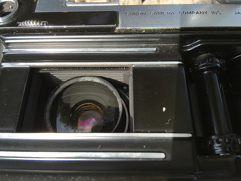

My J12 mounted on my L1 Santino. Very close clearance, but it did fit.
John Mc
“J-12 mounted on my L1-Santino ... It fits” — and his j12 has the metal ring around the rear element, which seem to be the troublesome versions.
There appear to be some variations in the J12 rear element—they’re not all exactly the same size. This appears to be most critical with the Canon P: some J12s barely fit in a P, some don’t (mine fits). I suspect the L has a tiny bit more leeway, but I say this only because I haven’t heard complaints about J12+L. So anecdotally, you’re ok. Good luck 🙂
