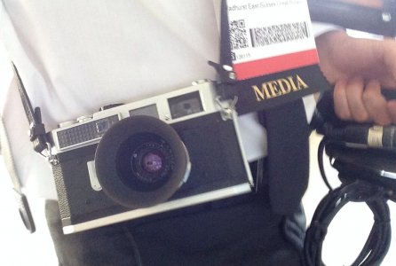

Old photo, but...
The biggest problem with the J12/Canon 7 I had was the lens is far too late for the camera to balance properly. I spent the best part of a week covering a giant trade show in Vegas with that thing tipping backwards and jabbing me in the side whenever I wasn't using it.
Still, got some fun reactions from people who were surprised to see that being used alongside whatever digital kit I was using back in 2013.
In fact, that'd be my number one tip for picking lenses out for the Canon 7: pick something heavy if you plan on using it with a strap. Almost every LTM lens I have causes it to tip backwards; it's really annoying. The only solution I found was to use a tripod mount strap lug and swap it to a vertical hanging setup, a la M5.
