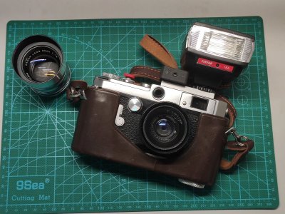

Hi, guys. I'm a newbie, so excited to register as a member. I bought a Canon ⅤT De luxe with Serenar 50mm f1.8 and Jupiter12, and shot some photos, and I found that the color of photos shot by Jupiter12 is richer( thicker? or more colorful, I don't know how to describe it, forgive my poor English) than those shot by Canon Serenar.
Here is my confusion. I prefer to take photos in color, and I heard that the vintage LTM lens is more suitable for B&W photos.Is this viewpoint correct? If this viewpoint is correct, is there any lens recommendation for taking color photos?
Thanks, and here is my camera, and some photos to share.20250111204004.jpglove the trigger winder000072390030.jpgshot by Canon Serenar 50mm f1.8

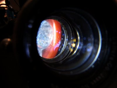

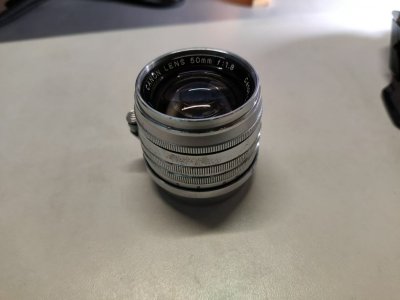

Sorry to bother you. My first time using the forum! I thought a previous post had been edited but somehow it wasn't posted in the correct format, only photos were posted.My Canon 50/1.8 is Chrome version. I checked the lens through a light and other than a little blur around the edges, it doesn't seem to get haze.

No bother to me!
I see a spot of possible fungus, and some light haze. It's always hard to tell without inspecting the lens first-hand.
This one is clean, after I took it apart. Easy job- retaining ring holds barrel in the focus mount, then rear group unscrews. You need a simple optical spanner for this.
I put a piece of lens cleaning paper over a flash light, taken at an angle. The lens is clean, like crystal.

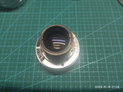

I disassembled and checked my lens according to a tutorial, fungus and possible haze are all on the edge of the middle lens element. Sadly, the threads of the middle lens element are damaged, I couldn't continue to disassemble it. (And I saw some scratches on the midle retaining ring, I guessed someone had tried this before.) So I just cleaned the rear and the front lens elements.
I will continue to find a solution, but until then, it seems that I could do nothing.
