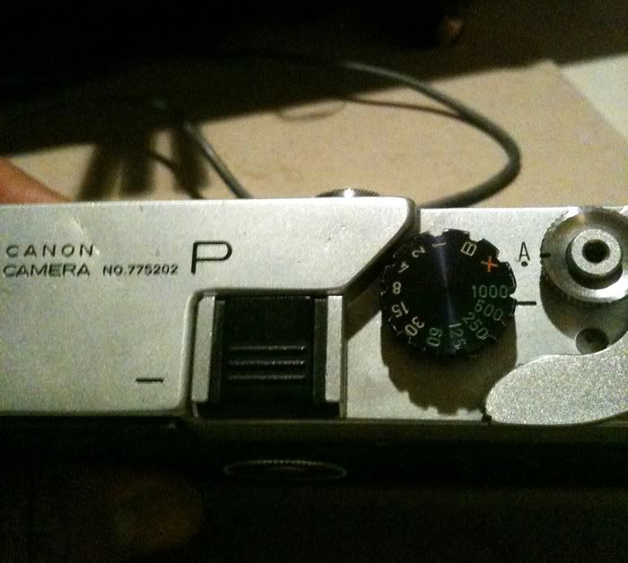

I noticed while looking through some pictures of P's that they all had white shutter speed numbers and i realized my P had green numbers from 60-1000. Any reason why this is so?
There was a time when camera makers colour-coded their shutter dials to indicate either flash synch ranges, or at least to mark off which shutter speeds ran with non-full opening curtains. The Canon P sync's at about 1/40 or 1/50 (the X mark on the dial) so this means that starting at 1/125, the shutter blinds will traverse at about half-width slit.
Contax did this too, and so did Praktica and hosts of other makers.
