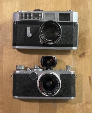

(I'm not sure how well this translates in a photo, but the Leica Ic makes the Canon 7 feel massive.)

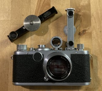

This is how the rangefinder-less Leicas were intended to be used (when they weren't mounted on a copy stand, or attached to a Visoflex, or so on):
You use an accessory rangefinder (the FOKOS attached to the camera is mounted how you would use it; the FODIS next to it is positioned so you can see the focus dial) to measure the distance to subject, then transfer that reading to the lens before composing via the accessory viewfinder.
Is this a ridiculous way to take photos when you own a bunch of cameras that have coupled rangefinders? Yes.
I still don’t understand how the ‘periscope’ works - so you measure the distance looking through the little viewfinder?
The side of the FOKOS/FODIS with one eyepiece gives you pretty much the same view you get looking through the separate 1:1 RF in a Leica II or the 1x setting on a Canon. You spin the giant wheel, align the images, and then read the dial to see how far away the subject is. Very handy thing!

The Canon 7 (and 7s) is much larger than the IIIf and feels a lot less solid. The viewfinder in the Canon 7, while large, means the rangefinder is harder to focus for me than a IIIf due to the lower magnification. I wouldn't trust it with anything long and fast wide open.
Also, on my sample of the Canon 7, I can sometimes see "ghosting" where the non-selected framelines are, and due to the design of the RF patch, there's always some distracting weirdness going on around it that I can't describe:
The IIIf's rangefinder window is much smaller, but much less distracting and much easier to work with - again, for me at least.
