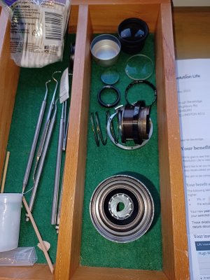

I was out recently with my Contax IIA and Carl Zeiss Sonnar 135mm F4 when I noticed the aperture blades began to seize up, probably due to oil on the blades.

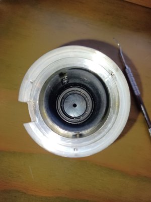

I decided to dismantle it seeing that a CLA cost probably far exceeds the value of the lens. After removing all the glass elements I can reach the aperture blades from both sides but I need to be able to reset all the blades in their slots.
There's no obvious way to further dismantle the lens and separate the aperture mechanism from the barrel. Does anyone have any tips or resources that could help?

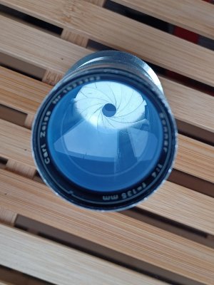

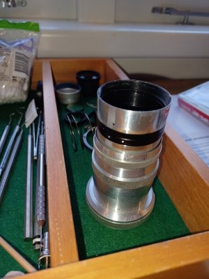

Problem solved! I didn't dismantle the lens further, but with careful manipulation of the aperture blades with an old dental tool I was able to slot the loose ones back into their positions. After cleaning the blades as much as I could I cleaned the glass elements and reassembled the lens. Phew.
