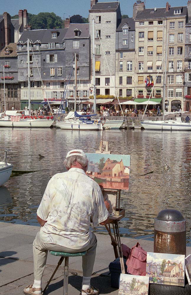

Here is a color scan from my v500. You can see it on the edges of the shirt but I don't worry about it.
