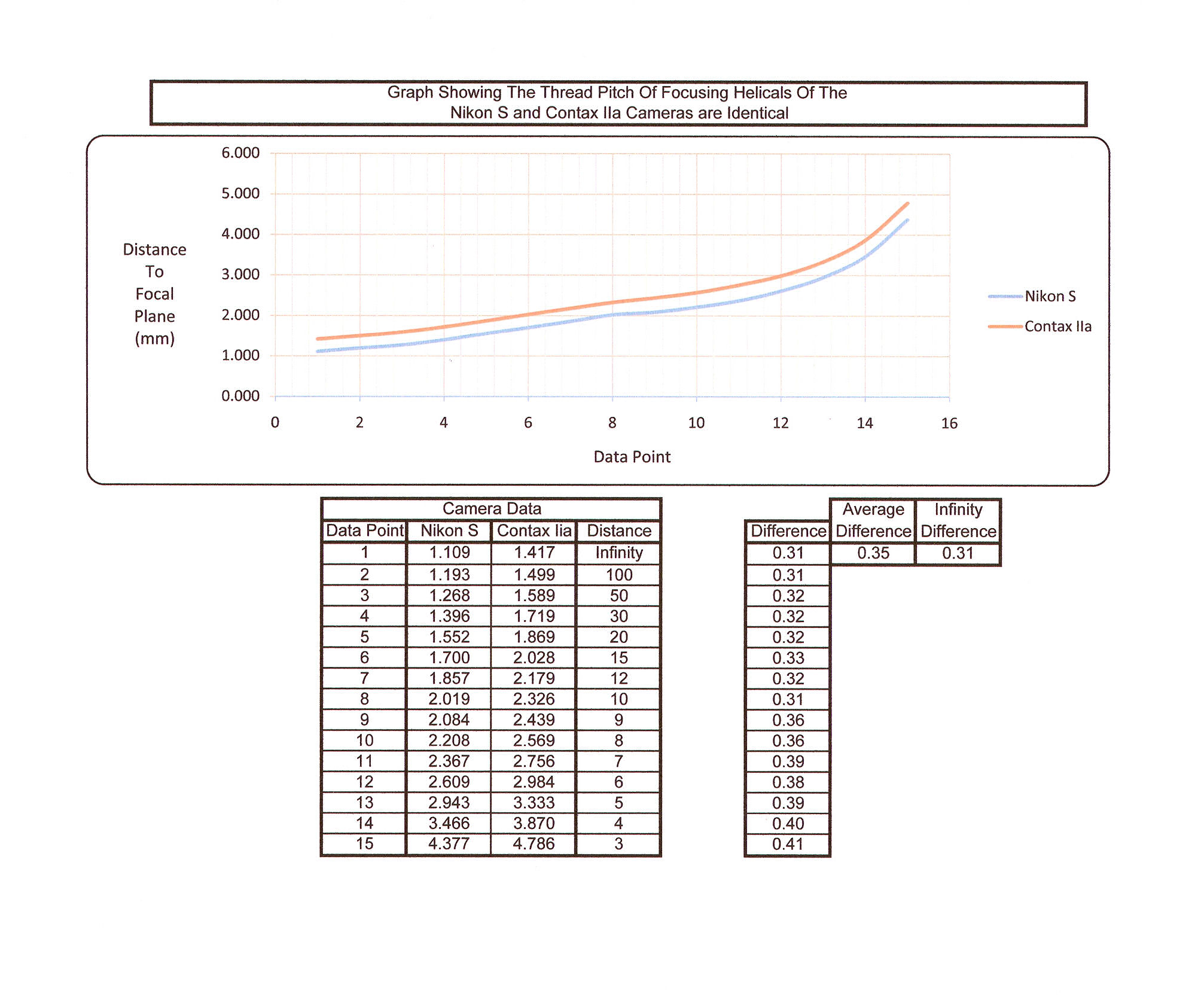

This is very interesting... 0.31mm is a very small diference.
I think that COSINA could create a Nikon/Contax Universal model, whith a Nikon to Contax selector, which could move the lens mount 0,31mm out and in, to get ready to use both systems...

The reason for the problem you found is that you tried to compensate the diference by adjusting the helical, but what Mr HS says in the Zeisscamera site, is that you should move the whole mount, and in such a case the rangefinder will work for all distances included infinity.
Ernesto
Ernesto

Well, obviously I think the oposite.
And will prove it now:
You say Nikon normal lens has not the same focal lenght as a Contax normal lens, and also you said that every diferent focal length needs a dedicated helical with a unique pitch.
Ok, so explain me how can Nikon Mount share the same helical pitch with contax mount?
The only answer is: both helicals were designed for a 50mm focal length lens.
Now I will explain why Nikon lenses cannot work properly in contax mount and viceversa:
Because they located the mount at diferent distance from the film plane.
It seems simple to me...
Ernesto

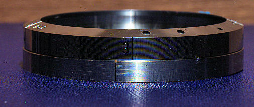

It's easy, you are wrong. The Helical on the Nikon does not travel as far. It is made for a 51.6mm Leica standard focal length using a Mount that has the same physical connections as a Contax. The Contax camera uses a longer focal length, nominal 52.4mm. The travel from close-up to infinity is longer on the Contax, or else all of you photo's are out of focus.
Simple rules of Physics.
You simply do not know what you are talking about. Seems really simple to me.
It's easy, you are wrong. The Helical on the Nikon does not travel as far. It is made for a 51.6mm Leica standard focal length using a Mount that has the same physical connections as a Contax. The Contax camera uses a longer focal length. The travel from close-up to infinity is longer on the Contax, or else all of you photo's are out of focus.
I am sorry but you are wrong.
If the pitch of two helicals are the same, it doesn´t matter if one of them is longer or shorter, they both will move the same distance, if they are rotated the same angle.

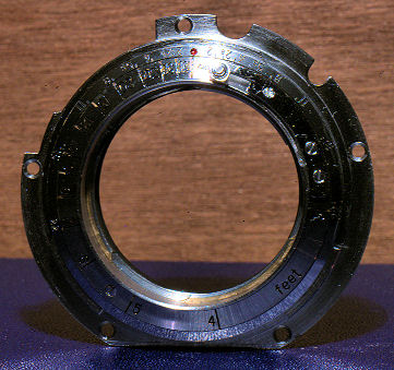

http://www.zeisscamera.com/N-C RF Pictures/FrontContaxWNikon.jpg
In this image you can see a mount made with a Nikon and Contax components, that proves they share the same pitch.
Ernesto
They rotate at slightly different angles. The travel is shorter on the Nikon. Or else it would focus past infinity.
You are wrong, or you are claiming the laws of physica are wrong. I side with the laws of physics. I guess others will side with Mr. H.S. I can't help you with that, but I did get an A in Physics.
Now- I've done this modification on a Nikon S2 over 5 years ago. I know that the Sonnar does not quite reach infinity, for a fact. What have you done?
The Nikon mount is made for a 51.6mm lens. The distance that it moves from the film as it is focussed between 3ft and infinity is smaller than the distance that a 52.4mm lens moves when focussed between 3ft and infinity.

Look at this image:
http://www.zeisscamera.com/N-C RF Pictures/FRings5.jpg
It shows contax and nikon distances, compared.
In fact the contax shows a higer angle compared to nikon, at 3feet.
So, what you say is that they share the same pitch but not the rotating angle, therefore the lens to film plane distance....
am I right?
Ernesto
I don;t get the meaning of that image. It does not show how the lens is mounted into position, or its distance from the film. It is irrelevant.
If the helical has the same pitch, then the rotational angle on the Nikon must be slightly smaller than the Contax. The focal length of the lens is the real issue. The focal length of the Nikkor lens is shorter than the Contax lens. Not by much, but it is a real effect that cannot be covered by the DOF. The travel of a 51.6mm lens is less than that of a 52.4mm lens as it crosses the range from 3ft to infinity. There are ways to deal with this, one is moving the point of exact agreement when using a Sonnar on a Nikon. It shifts the error, and more effectively uses the DOF to cover the residual error. The seocnd way is to reduce the focal length on the SOnnar by moving the rear module in. The third way would be to change the RF calibration of the Nikon, increase its eccentricity.
